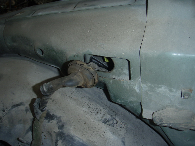

And hidden bolts you have to reach from inside the wheel arch
[Immagine: P3070742.JPG]

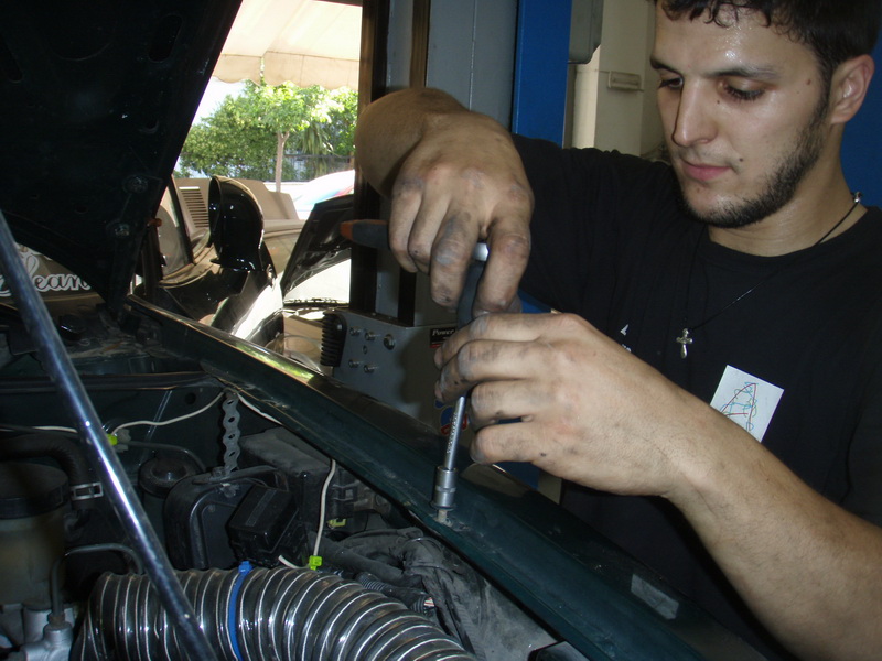

The only holes not already there, are two 10 mm holes on the to bracing point.
Use the holes of the Arrow to guide you where to drill.
[Immagine: P3070729.JPG]

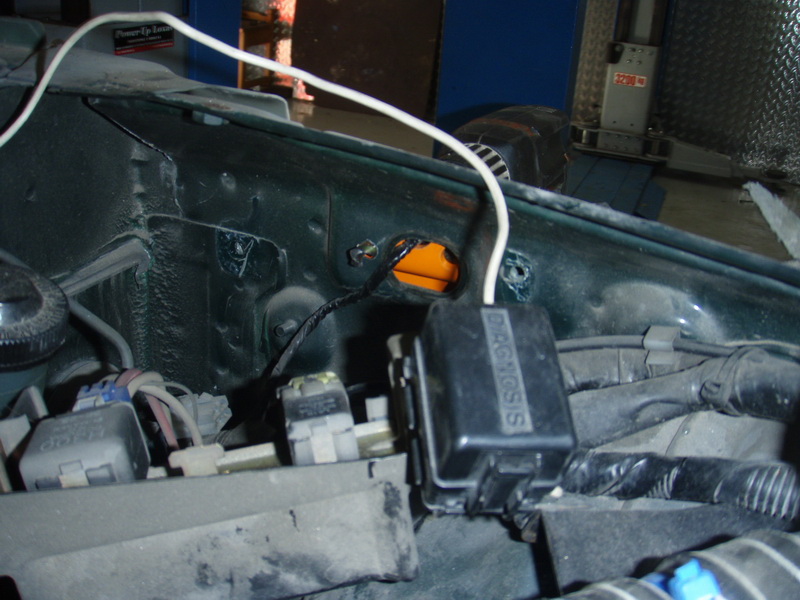

From the inside of the wing, undo the fuse box,
[Immagine: P3070730.JPG]
to gain clearance and fit the metal plate provided.
[Immagine: P3070731.JPG]
Use the provided alen bolts to tighten
[Immagine: P3070732.JPG]
